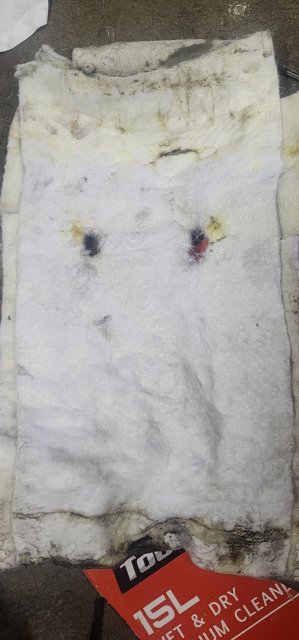

Awaiting also a new thermal blower blanket from VCM over in my neck of the woods to replace the one originally on my unit when I bought it. The photo doesn't fo it justice but there was quite some oil attached on the inside of original blanket....guessing that ain't adhesive.
Maybe the previous owner cut out the breather ports a Lil shy of target.

I noticed the oil too. Maybe the blanket was acting as a filter too!? ;-)
Yes I'd definitely say so
