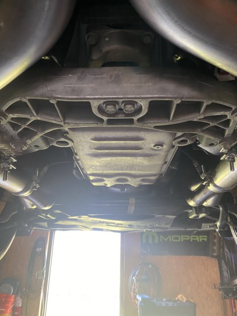

Thread Starter #16
Went much smoother than expected.
dropped K member to the last few threads on the bolts.
got all manifold and header bolts from the bottom.
I’m used to stock bolts being too long and the TSP kit did not come with bolts.
I had a set of 12pt ARH bolts I found in the tool box.
the worst part was I apparently only have 1 12pt 10mm socket
I really was surprised to not only finish today, but I didn’t even stay late!

On my old '13 mustang I found dropping the k frame made the job much easier. I would unbolt it and let it swing down leaving the steering and such attached. I didn't look much at doing that to the Charger but sounds like it helped you.

Not a big fan of the motor mounts. We spent a lot of time getting them back on when we installed the headers. When I took the headers back off I left the mounts on. Had to remove the knock sensors but had the headers off in a 3rd of the time it took 2 of us to but the headers on
