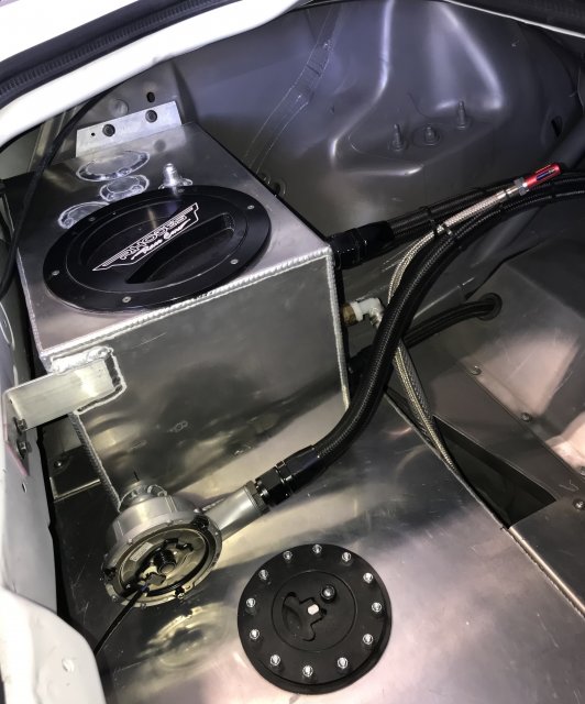

Yes. Too big to even be a option with the side mount PNR. This is what I’m using now. A custom 10 gallon tank. 0D791369-DB17-4368-BA2D-9E8072C5ACAE.jpeg
3,602
11,617
Screen shot of a video showing the flow of coolant returning to the tank with the 1” lines and 40 gpm pump. AC2B8513-D2D1-4BE4-9997-11D86F58AA89.jpeg

No. I don’t drive the car on the street anymore so this is for track use. I’m using huge 1” lines to move a lot of coolant thru the big DragPak intercooler.
