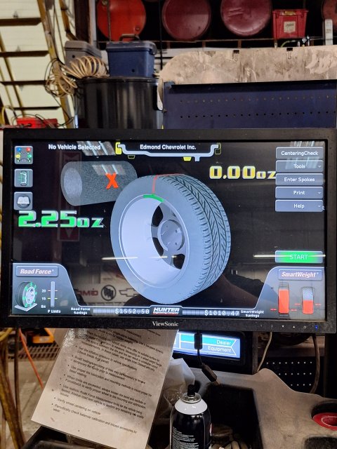

Verdict is in. MT's QC group led by Ray Charles can eat a fat stack.
This is one of the radials that just came off this set of wheels. Believe about 3/32 left from the 5/32 new and the old set balanced out around 4.5 and 6 total ounces last time. I wonder what changed...but this 100% confirms both tires were trash. Can't wait to see the 3rd.
