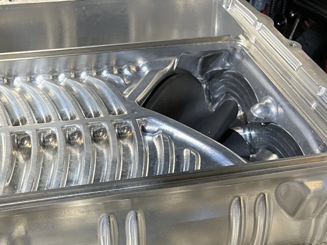

Check the rotors. Two easy ways to do that. Pull the lid to see the rear or pull the throttle body to check the front (easiest). The original billet version in the first picture. It’s got 30 passes plus dyno time on it now and makes a ton of power. Over 1400whp at 3000’ elevation thru a T400. It’s still in perfect condition. The second picture is thru the front of another that started eating itself. We’ve found that they don’t like rpm. Anything smaller than a 3.50 pulley is a problem. Stay tuned. It’s a saga. 😂 View attachment 132919 View attachment 132920
Marc,
How to tell if the unit is billet? Is there a serial number that indicates that it is billet or can it be determined visually?
Pull the lid off and you can see the CNC tool marks here and there. The inside has that jewelry appearance compared to the cast look. Here’s my Billet inside…. IMG_0317.jpeg IMG_0318.jpeg

Pull the lid off and you can see the CNC tool marks here and there. The inside has that jewelry appearance compared to the cast look. Here’s my Billet inside…. View attachment 133217 View attachment 133218
Thanks for the information, I am pushing real hard to make Dan's event on April 5 and just dusted off the whipple box, I purchased it a few years ago when they first were released for Dodges.
