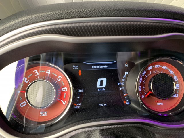

Ok I think I have one of the first sets of bypass harness‘ made by Ron for the 15/16. I tested both my 15 HC Charger and 16 HC Challenger in the same manner.
step 1. Start the car with everything connected in factory settings. Allowed the airbag to self test and light went out
Step 2. Unplug both factory harness from the seat and start the cars. I let them run for a bit
Step 3. Plug in both bypass harness’ start the car and let run for awhile. Airbag went out in normal time.
4,981
9,436
why is seatbelt light on in pic 3 ? …..does it stay on with bypass plug ?

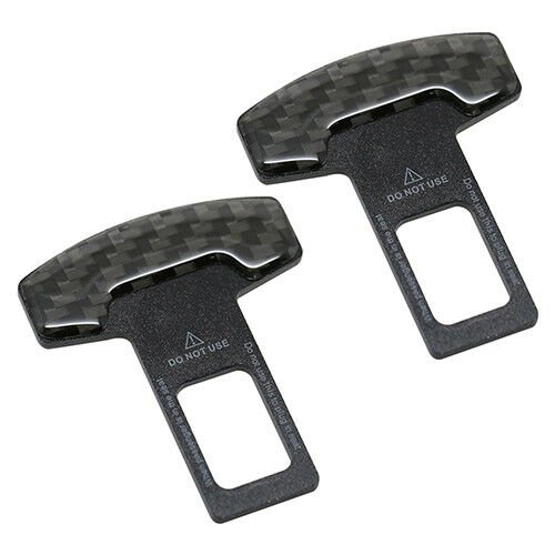

I only said it will turn off the airbag light. But if you want the seat belt light to remain off then it will require a redundant seat belt buckle that would add substantial cost or the harnesses can be made so you can unbolt your OEM buckle off your seat and use that for no extra charge.
This is the redundant buckle version. I am pretty sure you would have to plug in a clasp into the drivers side to eliminate the seat belt light. They can be bought on E-Bay to eliminate the chime.... RITTER.jpg s-l640.jpg
I didn’t have my (drivers) seatbelt fastened. When I fastened it the light goes out.
