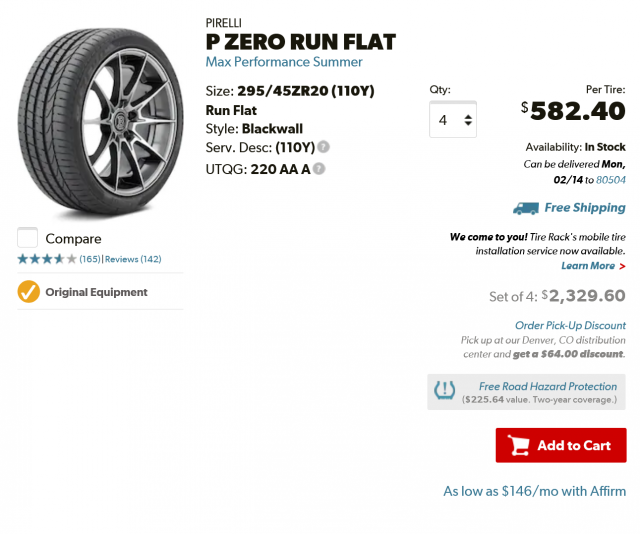

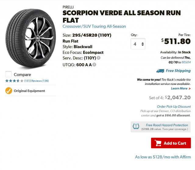

I did check on tirerack.com and sure enough, the OE tires are ******* expensive at the moment! Not quite $3K, but maybe close enough.
The Summers are more expensive...
Non-Runflats...
Tough pill to swallow, but it's the price of driving a SRT Durango I guess.
