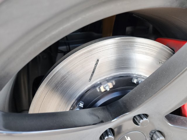

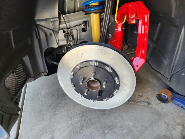

(A couple of on-car shots of two different iterations)

Those fender wells seem to clean for a test car 😉

He can be a bit OCD
