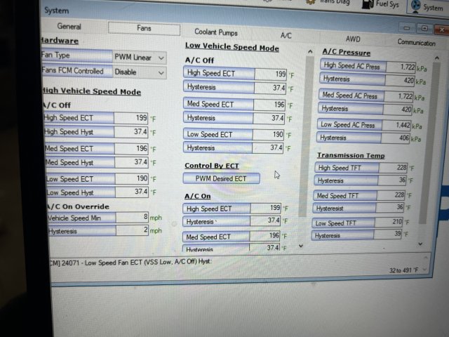

So just a thought here. Your car was retuned is it possible the tables were set to Celsius and they put Fahrenheit numbers in?

Thanks. Go to system, fans and look for?

Just looked. Farenheight
4,261
10,593
Ok and the numbers make sense right? Because I could write a tune in C and then you could open it and it would convert to F

Pwm linear is on. Fan fcm disabled.

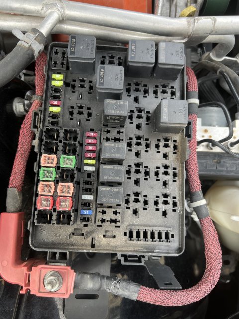

I will try taking a picture.

160’degree thermostat. Pwm desired ext set to 163

Great idea. Single fan, Hellcat, uses an inline dropping resistor for slow speed fan ops. For high speed ops, it's full 12v. There are 2 fuses 3 and 19, in the front power distribution block, as well as 2 relays (hs and ls).
All can be checked, in a few minutes, except for the dropping resistor.
If you have AlfaOBD, you can ping the fan and check relay ops and fan ops.
Sometimes, with those 50 amp box fuses, it's easier just to replace them.
Lastly, no harm in removing the relays and wiggling them, in the socket. Oxidation can cause havoc, depending on how humid your area is, or has been.

Am I missing any fuses or relays?

They look all there compared to pictures on the net. The 50 amp ones look like toast.
