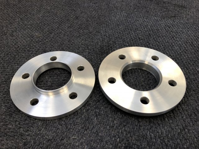

3,323
7,860
F06F1E95-27E3-49A2-9A47-AE2211231D06.jpeg B1CB5A3B-D086-4BB5-B909-AE0998553D62.jpeg C8458FFD-9D3A-4776-8214-90EE57864346.jpeg D8576528-0DE0-4EA8-B434-47A0730A7DA9.jpeg A66E61F1-D16E-41CC-96E9-35CA815F16F5.jpeg I still can’t take a hammer to my car, my 315/50-17’s will just see track duty and I doubt anyone is going to notice 12 mm of extra stick out from the spacers I made so they don’t rub the rib. Nice write up though
