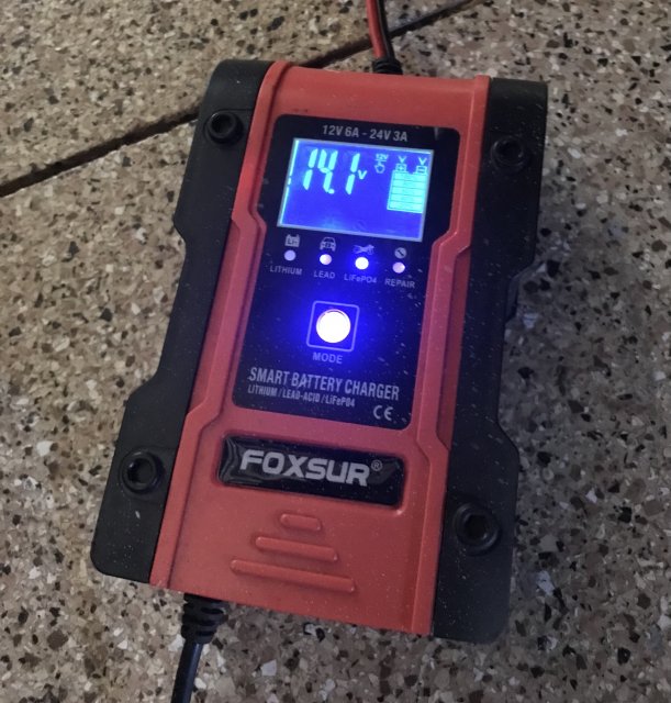

Yes you do. This is the one I’ve had for years and it works great. image.jpg
