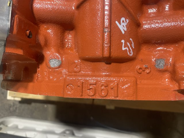

Time to reveal this bad boy since y’all saw I was looking for a shell.
IMG_7247.jpeg IMG_7248.jpeg IMG_7249.jpeg IMG_7250.jpeg IMG_7251.jpeg IMG_7252.jpeg
This is my 6.2 racing longblock that will be going into the hellcat. The car has 67k on it and this was designed to be a normal block that can handle some serious power. Built by MMX to my specs piston and rod wise and could handle well north of 22psi which is what I run now. The old Hellcat motor is a rare block, it is an early block with no BGE stamps. It is being sent to MMX for a refresh and will be turned into a 411 stroker for the shell. I haven't decided on forced induction path yet but I’m looking at entering the 8.5 index or heavyweight and I mean 7s/8s heavyweight.
View attachment 105882 View attachment 105883 View attachment 105884 View attachment 105885 View attachment 105886 View attachment 105887
It doesn’t say BGE on the back of the block? I have a real old hellcat block that says 6.2 on it, but in the bsck by rear main it’s still stamped BGE

3,505
11,287
Good deal! The “old” 6.2 block (15 & 16)) are stronger. They have a higher nickel content and are the desirable block for a big hp build. A new BGE is generic now.
Well that’s a bummer my new block is a 2021…

3,505
11,287
. Nothing wrong with the 6.2 BGE. I’m guessing that when they first came out with the Hellcat, they overkilled the block a bit. Concern of the unknown. Afterwards they started using the standard BGE specs. A “source” told us that the early 6.2’s were a stronger metallurgical deal that they later determined wasn’t necessary for the stock Hellcat. For somebody pushing a1500+ hp build…that is good to know. For most it won’t matter.
4,363
10,843
Sad part is they were much cheaper then to 🥲
