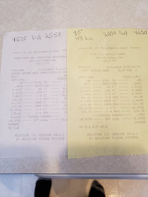

New personal best but it was in better DA. Went 10.82@127 1.60 60 ft. DA was 1260. If they would have ran at 10 like they planned on DA would have been around 500 and I'm sure I would have been in the 70's. My next pass had a 1.59 but the DA went up 500 ft and ran 10.87. The right lane shows more MPH for no reason. I ran a couple of 128mph but I know it was just reading higher by the rest of the time slip. Looks to be 2-3 mph more. If my 1st pass would have been in the right lane it may have shown 130.
From what I can tell, the cat deletes are not worth anything. I'm attaching two time slips. The one on the left was from 8/29. I was running the 20' Nittos compared to today where I had the 17" with M/T's. The temp was about 5 degrees cooler but the humidity was around 59% compared to 43% but the DA was about the same. I ran the same time and mph in the same lane even about the same time of day. Tomorrow temps should be close to today so the plan is to put the cats back on to do another comparison.

I was hoping for some more HP but the good news I can put the cats back on and have no smell. I did get a few compliments about how my car sounded:)

So made 2 passes yesterday with the cats back on. Track was busy as expected but found out what I needed to know. Temps were steady at 70 all day and so was the humidity at 70. I ran 10.98@125 at 1975 DA. Friday in the same DA ran 10.95@125. But the humidity was 30% higher Saturday so even though the DA is the same the higher humidity will slow you down.
So it safe to say at least on a stock Hellcat there is no gain with cat deletes
