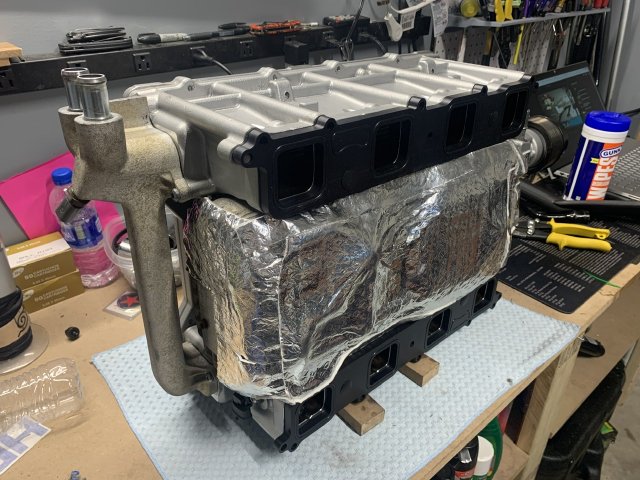

Ripped apart the engine bay for a spacer and blanket install.
Everything is disconnected just gotta wait for a friend to help me lift the blower. 103 lbs is just awkward to move from this postition by yourself. Had to give the supercharger a tappy tap tap with a rubber mallet to get her to budge. While she is out gonna clean that engine bay.

She’s a big girl but big girls need loving too. The engine valley and the blower will be getting detailed tonight before being put back on.

Cleaned the hell out of the engine bay while I’m in here.
Got the spacers and blanket on. Kinda felt like pilutting a diaper on a baby, a metal baby that takes air molecules and makes then angry and forces them to go on dates with gasoline molecules and then they create combustion babies after prom night...
Definitely need a friend to help me lift it back on. Plastic spacers, rubber seals and sliding on wood do not mix... lol.
