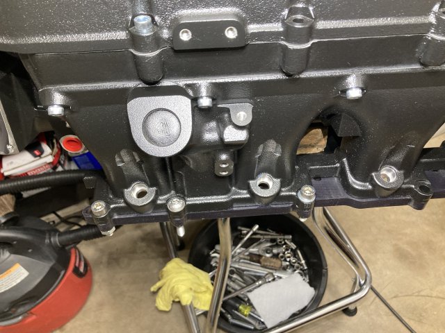

No, these are original FI insulator plates but I can add spray bars to them, I can gun drill them end to end, someday. The bracket I will post pictures of where and how it goes, took me a bit to figure out how its intended mounting is.
I will locate the plates with dowels into the heads but not into the blower as there no holes for them nor screw holes to secure them to the bottom of the blower like is done on the IHI

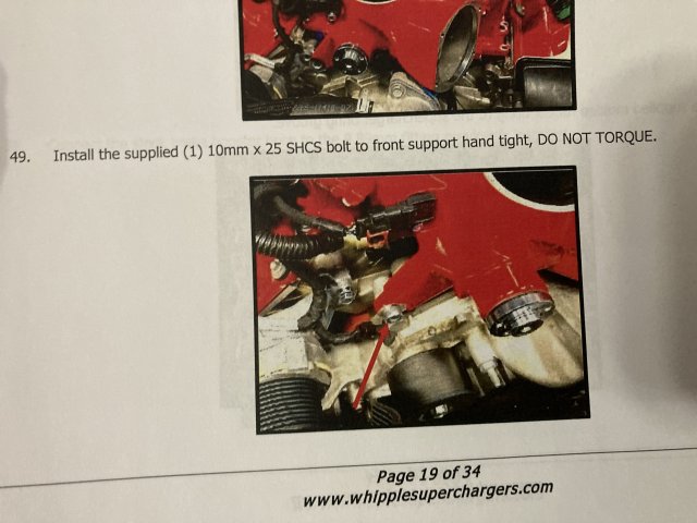

That bracket goes here, bracket bolts to the back of the water pump flange then the flange in the SC bolts to the other hole in the bracket.

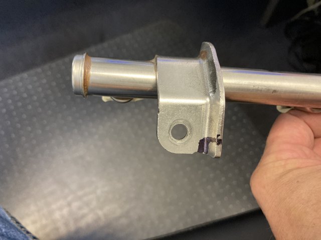

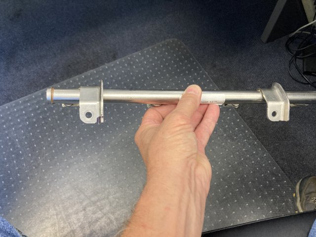

Here’s what needs cut out of the stock drivers side fuel rail mounting bracket, the instructions show this needing to be done as well.
