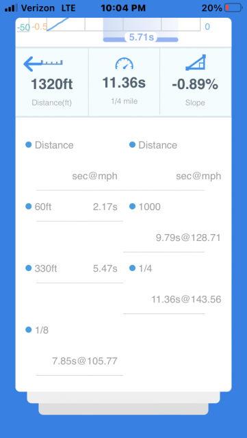

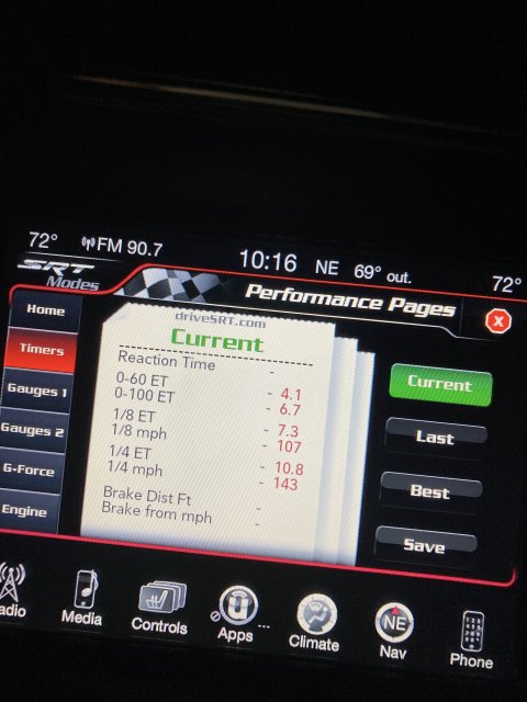

And what else did he do while we were at it last night??? Whipped up a quick launch tune and Got me into the 10’s!!!!!!! It still has allot of tweaking needed as I’m spinning like mad still but a 2.2 60ft on the street still netted a 10 second 1/4 finally!!! YAAAAYYYY!!
Party time!! I’m sure 9’s at the track will be no problem!! Issue now is I’m running out of rpm before the 1/4 completes, see the mph knee over at the top? 1/4 speed could actually be faster as I slowed down before crossing the line. Guess time to up the rpm limiter a bit so I can stretch it out a hair more up top. Or go back to the 3.73 rear but that may slow the cars acceleration in 3rd and 4th, don’t want that!! Unfortunately I ran the battery dead on the Draggy so the 10.8 isn’t on the Draggy, ran my laptop dead so couldn’t try another launch tune Jon concocted quick, the my phone died, and finally I was out of fuel lol 1/4 tank sent me home finally around 11, with a BIG SMILE though!! :)

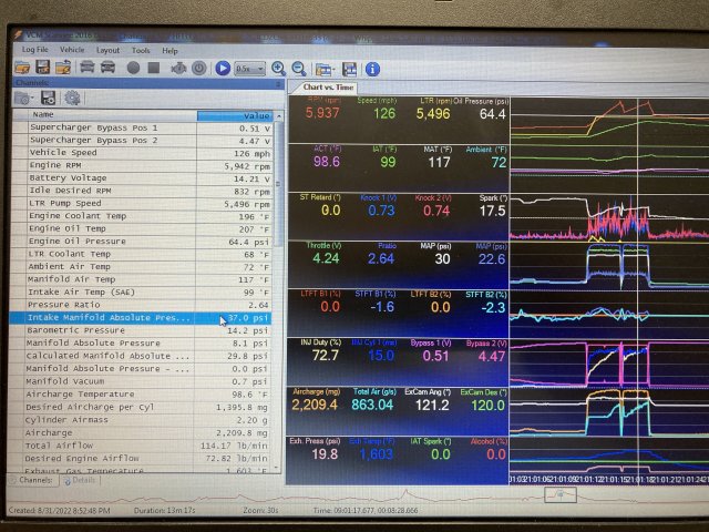

Here in the HP tuners graph can be seen the starting point is around 55, throttle voltage is just hitting max right at 56 mph. Near no STKR even exceeding 23 lbs of boost, look at that 2.70 Pressure Ratio and 2200+ Air Charge!! Remember this is just a RedEye cam on stock un ported cylinder heads with JBA 1 7/8” shorty headers THROUGH CATS and stock exhaust!!

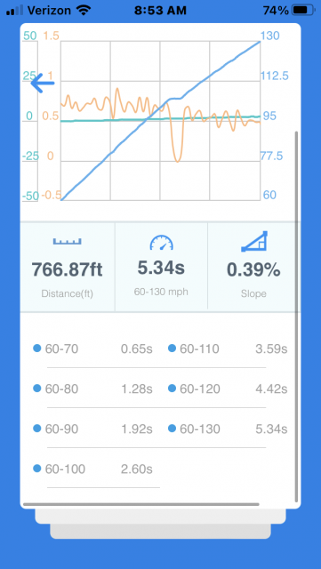

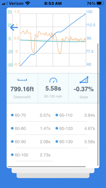

In actuality my 60-130 times are slower 2-3-4 verses just 3-4, that extra shift costs time. It may be quicker in the 60-70 range but the shift 2-3 costs time, see here in a 60-130 snippet from a 1/4 run. But I can start out sooner in third, like 35 mph as she has the torque even from 1500 rpm
In third to start pulling hard by 45-50 to gain some momentum in passing the 60 start mark, but I feel that’s cheating lol.
See the difference in the 60-70 and 60-80 times?
