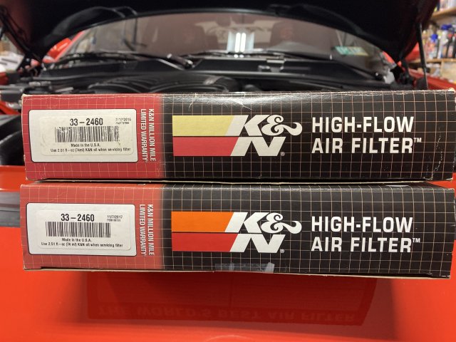

K&N filters for sale in the for sale section,$120 for both shipped.
88D370B3-FFED-425B-851E-63C83DAA6D55.jpeg 884811B4-E4FC-4E7E-BEB7-43ECC7FB30C9.jpeg BD8FBD1C-DF40-4E9E-9CA2-410959F34E8D.jpeg 7F47539D-304B-45F9-ABB1-6431A0BA78B0.png 70BA73FE-E98E-4815-BBC1-4FD47D07522D.png
