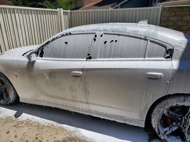

Went for a drive today and washed when I got home. 17,100 miles total. Good times with this beast.
