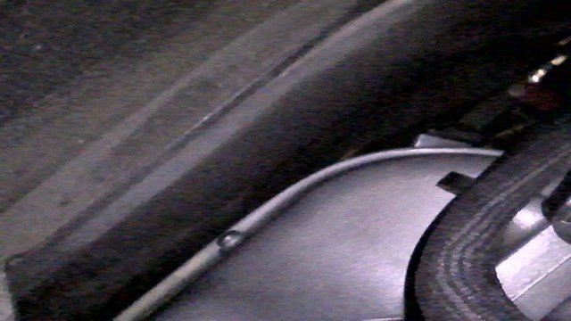

Over the supercharger mount was not gonna cut it. Decided to close the hood and boroscope to see how much space i was working with. Not a lot.
C6F92E6A-41C7-41F4-B4FF-753D3290B47D.jpeg Stared at the motor a bit and found running it behind the SC was the best option.
using a trusty ziptie to keep it off the SC and away from the wiper motor.
then just oriented one of the arms backwards
pretty happy with result, hobbs switch was temporarily mounted and ran all the map pressure lines to the regulator.
making progress! Up next is the feed to the Y block and then the return. Tomorrow im picking up a ORB to AN 8 90* fitting. Not a fan of the height to the valve covers.

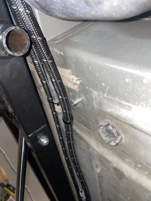

Not a lot of progress really. Got the triples in and the return run.
A86B02AE-8BA3-4CFF-8DB6-DCBA6A481AD7.jpeg BC580A39-A7D8-4FCB-B663-EF4C49F86738.jpeg
take note of the feed not being straight. Well come back to that. Had a osha violation, fitting failed while under the car on the quick jack. Heard a pop and ran like usian bolt to a safe spot.
frantically got wheels on and lowered it. Took the fittings apart, cleaned them, used this and some teflon tape, back in action
05981831-A8EC-4D5A-A714-8C59BCEE719B.jpeg C17299DC-A644-4FD9-8CCD-2D2E28524B96.jpeg
no leaks since…
Now getting back to the 45* fitting, fuck no, you have to lower the tank to get the hoses in and that 45 wont land the hose where its needed. Solution: take the -10 at the y block and just switch ends. Its perfectly fine for the 45 to hang from the Y block. Cant tell if fore ran out of fittings or if they are fuckwits… anyway return is run, however im smoked… did upgrade vise for making more an fittings

Decent progress, found that the 45* -10 fitting was a better option than the straight -10 over the fuel tank. However the fuel filter, yeah… this is how low it sat.
thats one speed bump away from a bad day. Instead mounted it in front wheel well.
Finalized the lines, one was too long and had to shorten it.
After a few connect/disconnects. Decided to move one of the lines over the master cylinder.
