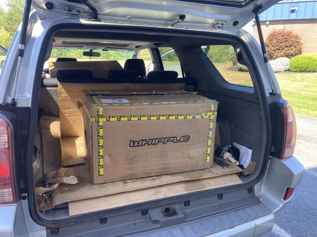

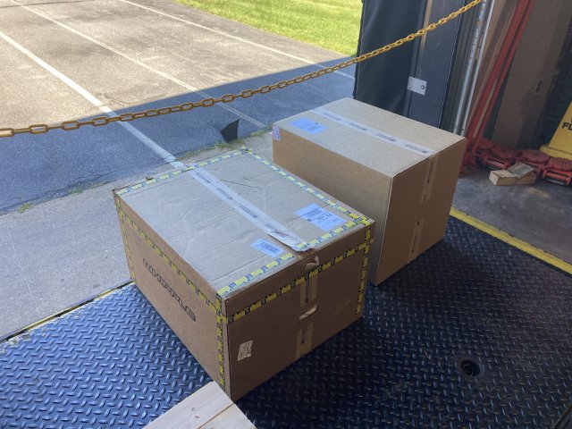

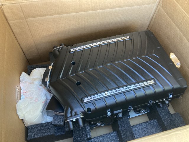

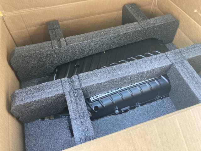

LOOK !!!! 👀
ITS CHRISTMAS ALREADY
8A750FCB-5D2E-4020-84E0-3E8AA02504DB.jpeg 1333BDDC-C044-4255-8EFC-A5C868CCD53B.jpeg 582C17EB-ED35-4FEE-9DD4-3878BFFF5269.jpeg

Sweeeet!

Everyone ready for the reveal? Is it a boy or a girl????
3,471
8,211
Thread Starter #913
WRONG!!!
It’s a BEAST LOL!!

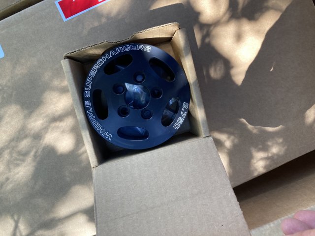

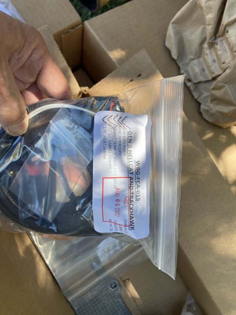

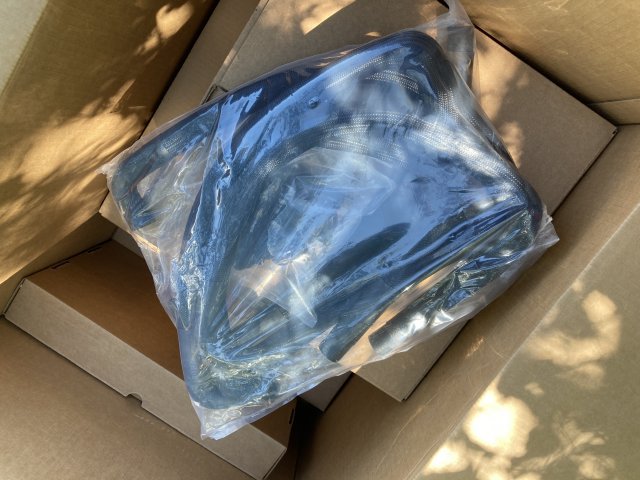

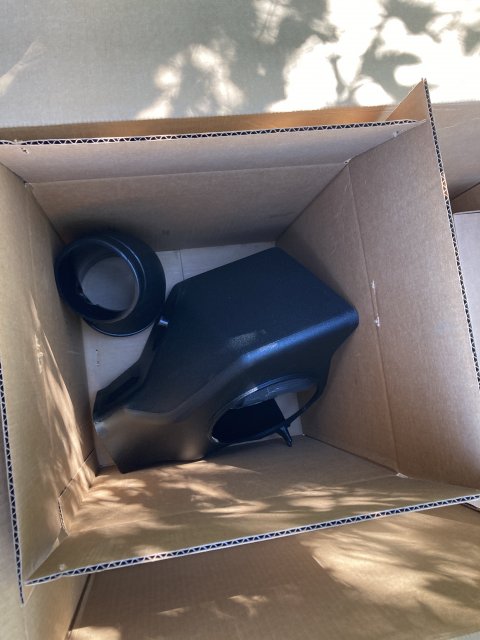

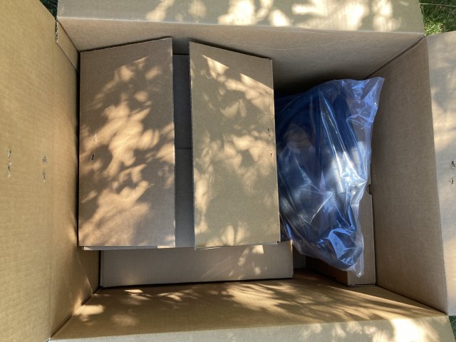

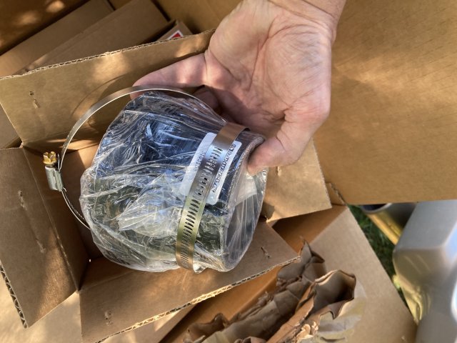

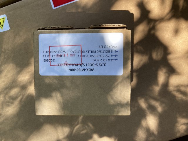

Here’s what’s in the other box.
E4C8501B-3639-4056-997A-03A723ACAB8D.jpeg 08A477B1-8979-4095-B5A7-02392B87F1A4.jpeg AC88E638-FA62-40F1-8C24-715EB95800F3.jpeg 4398D72F-A13A-4443-B061-59515F0F2DDD.jpeg F7BE4039-9AD4-4376-92DE-D2B4701B990D.jpeg 16A866F6-F81F-4FF2-873E-CB7C94AD0B19.jpeg CFD8096A-0263-40AA-8697-4329E2D9C62A.jpeg 76F7E43C-0610-494E-BEE3-ED4620A2B93C.jpeg DA17D05D-C49E-4BE3-AAE0-AAB8C9CFA7C6.jpeg C08C4B6A-E5CC-45F9-8902-DB1E88C4F160.jpeg 8E12FF3A-6994-44A9-8F84-819C6E598442.jpeg 9E3C4D93-9457-4D13-BDA5-2FE5D775035F.jpeg
3,471
8,211
Thread Starter #915
And a GREAT full color set of instructions with pictures of every step from taking your original blower off until the last bolt is installed and tightened on the new one, including Tq specs and diagram of sequence on the new one going on. Looks easy peasy everything included except for belt length suggestions needed for a non stock lower or upper pulleys. Hopefully that doesn’t delay start up I have a few different size belts on hand.

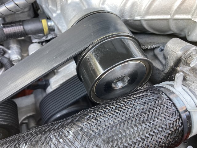

Well this past week my closest car buddy bugged me all week about going to the track on Friday night, he just converted his stang over to corn and was dying to see what it would run so I told him I’d go, most likely with my Capri. But after hearing from a few guys with the 3.0 Whipples that they are quiet and don’t make much whine I decided on Thursday I wanted to hear the cat whine 1 more time and get a video of her screaming down the track for comparison to the Whipple in the future so being I had yet another 2.72 on hand (used but looked like new) Thursday night I changed pulleys one last time to go to the track with my buddy and hear her scream one last hurrah. Put 1mm of shim behind this one to get a just under 2mm gap.

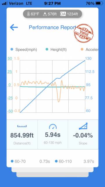

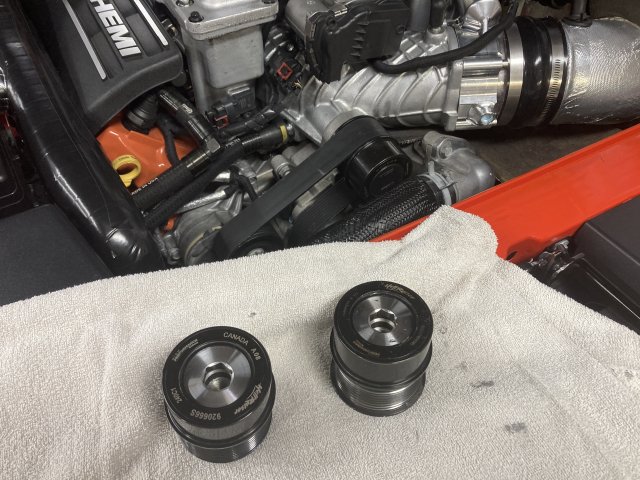

17A6C858-C5EF-4EE1-8FB0-FF303D9DA61B.jpeg 56EE918C-6B6E-4E98-9CE5-47C56E8951F9.jpeg 9037FE01-002E-45C3-8560-88EFAA072EA8.jpeg After supper took her out for a test hit and fuel up for track visit after work next day. All seemed good, 60-130 netted 5.85 and pulley looked fine when I got home.
B57F36EA-C282-48E2-B506-065BFAB17F84.png 3C47E8C0-4A92-4584-A838-04E2D3A05C46.png

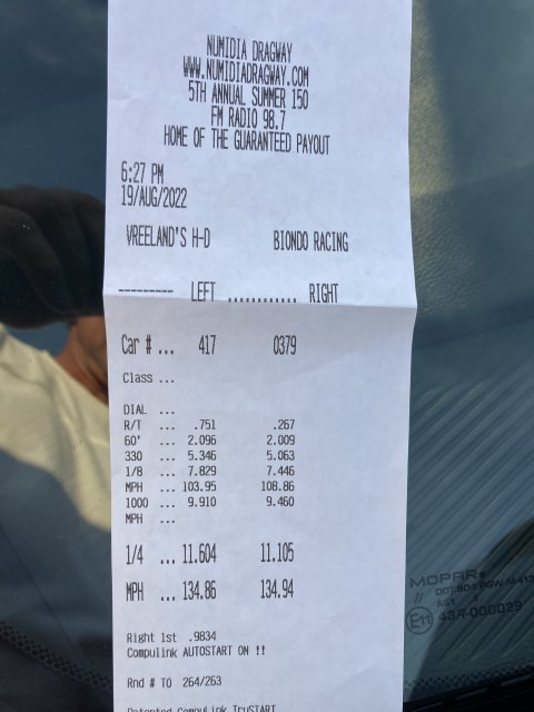

So Friday left work early got home and just loaded the essentials, laptop, chair, 2 helmets, smaller cooler with beverages, fuel tester, air pump and go, didn’t take the 17” tires and everything needed to change them, too much of a hassle especially in the blazing 92F sun, and I wanted to see what it would run in Street form with the 20” 305 555R2’s. Got to the track, paid my entry fee and got right in the lanes as things where just starting as we got there, only issue was record breaking heat yesterday, was 92F and humid, If it were not for my buddies enthusiasm to go I would not even have gone in 3300+ DA. So first pass after 54 mile drive there, even though chiller temp was 35 F and inlet below ambient when I got there blower heat soaked sitting for tech so my first pass I started with 50F coolant but 105 inlet temps in 3300 DA. Drove around the water, no burnout, ran against my stang buddy, tires hot showed 31 psi on the HMI ugh, do I did a soft launch to see it they’d hook and they did so rolled into it harder and hit second it hopped once and stuck, nailed third, forth, but seemed to be slow up top Hmmm. Ran a 11.10 at 135 with a shitty 2.0 60 ft but a decent 1/8 at 7.4 109 which should have netted 140 in the traps so back to the lanes to look at the log. Was Down 3 lbs of boost top of third and all of 4th WTF, so popped the hood and looked at the pulley first off to only find it face cover missing and grease all over FU(K my night was over :(.
48D18EAA-C64B-4FCB-ACC8-C7BEE7B1C908.jpeg 3C28FE31-9BCE-49B4-AE39-68E54AAF8551.jpeg 39F249D1-51FA-488D-9308-3A31E1070D9E.jpeg

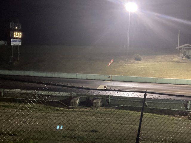

So got the chair and cooler out, got some fries and chicken tenders and had to have fun a different way lol.
F92FE74C-2969-443C-8799-9330856BFA17.jpeg F87B5EC3-41BF-41A9-BC55-B8AEB44B3B79.jpeg
SUCKED though watching the air sock show a tail wind and it was cooling off, DA dropped to 2200 and 73F Damn now was the time to be running :(
At least the car made it the 54 mile journey home, everything seemed normal on the drive home all be it I stayed out of boost. And I got to watch a modded new GT500 with Beadlocks and slicks run a best of 10.88 at 121, a highly modded Camaro ZL1 run 11.2 at 133, a Redeye run 11.5 at 134, was great to feel I could’ve stood up well to these auto magic cars if was able to get some more runs in I know she would have been in the mid 10’s at 140 if that damn pulley wouldn’t have shut me down, O well, better air is coming!! Next time taking the 17” sticky’s no doubt, 2.0 60 ft SUCKS!!
So what’s next? WHIPPLE TIME baby LOL. I Could probably get the swap done in probably 3-4 hours but I take my time on everything. Planning on changing plugs while the coolant lines are out of the way, borescope and do a leak down test of all cylinders, and install new 2309 plugs with a smaller gap, maybe down to .022 from .028 then put the Whipple on so stay tuned for updates!!
Today the wife has me going on a hike with the other grand parents then visiting a winery and out of the way little restaurant in a small backwoods town afterwards with GREAT food. Probably start on taking the 2.4 off Sunday AM, Supposed to get hot here again for the next week so good time for some work indoors in the air conditioned sardine can, I don’t even know where I’m going to hide these boxes with the Whipple in it from the wife until it’s on lol, there’s no room!! It’s Still in the back of my 4Runner 😂
